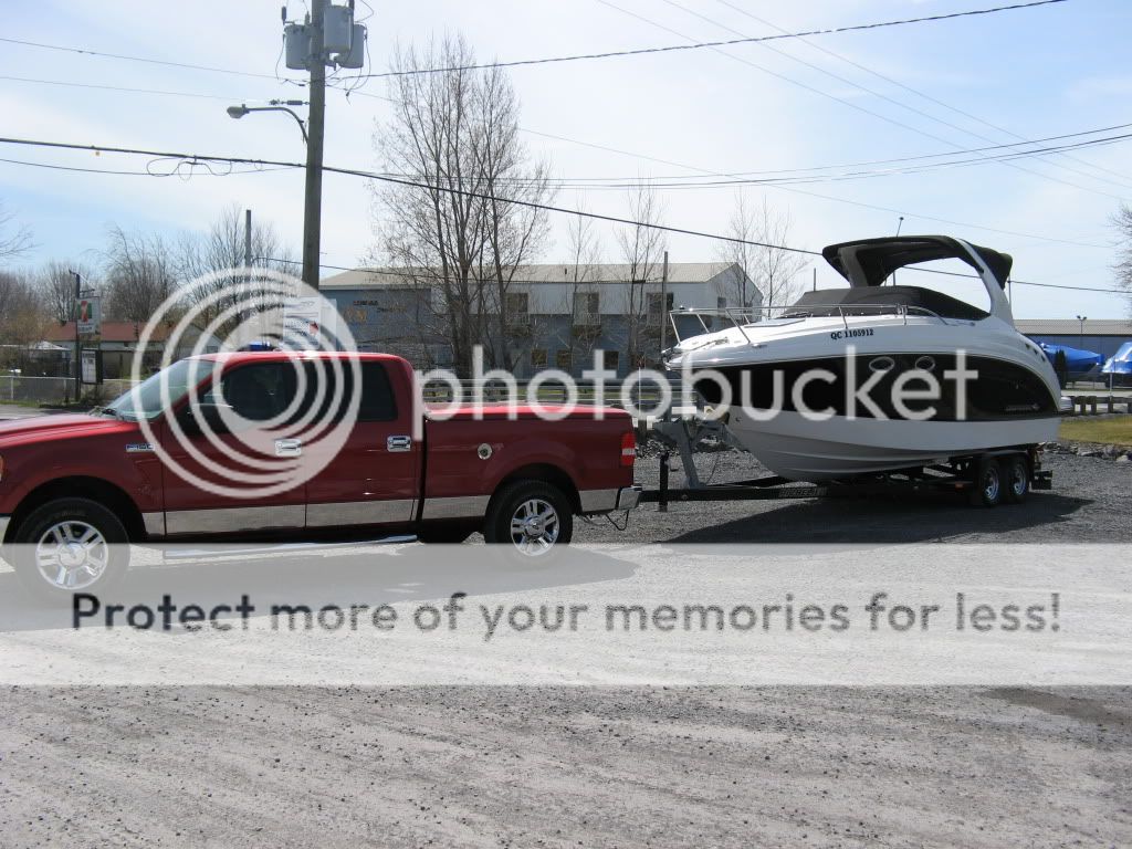

For those who asked for more information...
This is a Ford F-150 Triton 5.4 towing a Sig 250 (6,900 lb) and trailer (1100 lb)...
The Triton handles the load with no problem...

Nice looking rig.... :beer-7687-1:

Very nice looking rig! Your going to love the Sig 250...it's a great boat :beer-7687-1:
You may find that once you have all your tanks full that your going to be a bit heavier. I have a 250 w/5.7l, gen and AC, and the boat/trailer tips the scales @ 9700lbs with full tanks.

Might want to review this: http://www.fordvehic...rvF150sep09.pdf around page 4.
You might want to look into a weight distributing setup.

Nice looking rig you have there. I'm sure you get a lot of envious looks on the road and at the boat ramp!
I second the motion about the WD hitch. Anytime I'm over about 5K lb, I put the WD bars on my trailer. Not always necessary, but it's amazing how much of a difference it makes. The ride is so much smoother and I know I'm stressing my truck less as well.
The boat stays at the marina for the season. We only use the truck to bring it to and take it out the marina...
But obviously, I recommand a WD for regular towing.
