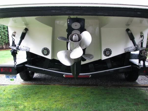

What you want to do is use stern straps from the stern eyes on the transom of the boat, under the swim-grid, to the trailer ....like in the pic - ours are on the outside of the trim-tabs
We also run a strap from the bow eye straight down to the trailer - in addition to the bow strap on winch & safety chain...see pic
Not sure I'd wanna run a strap up, over & down the back of the whole boat - putting pressure on areas of the stern not necessarily designed to take it.... Just a thought
