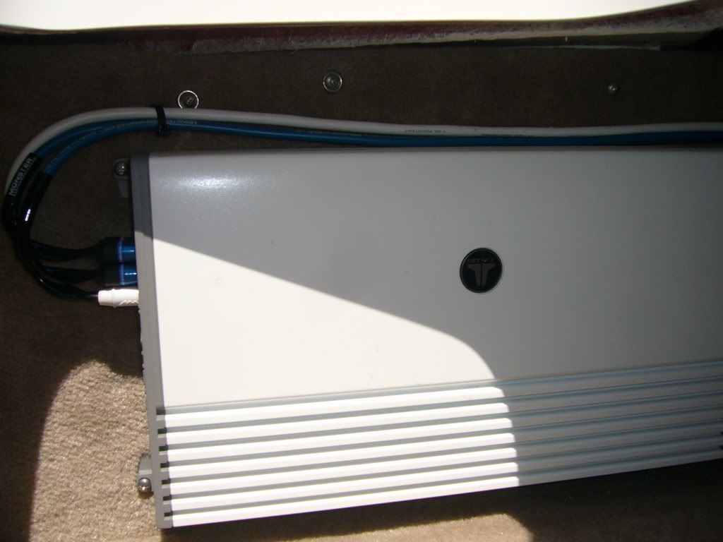

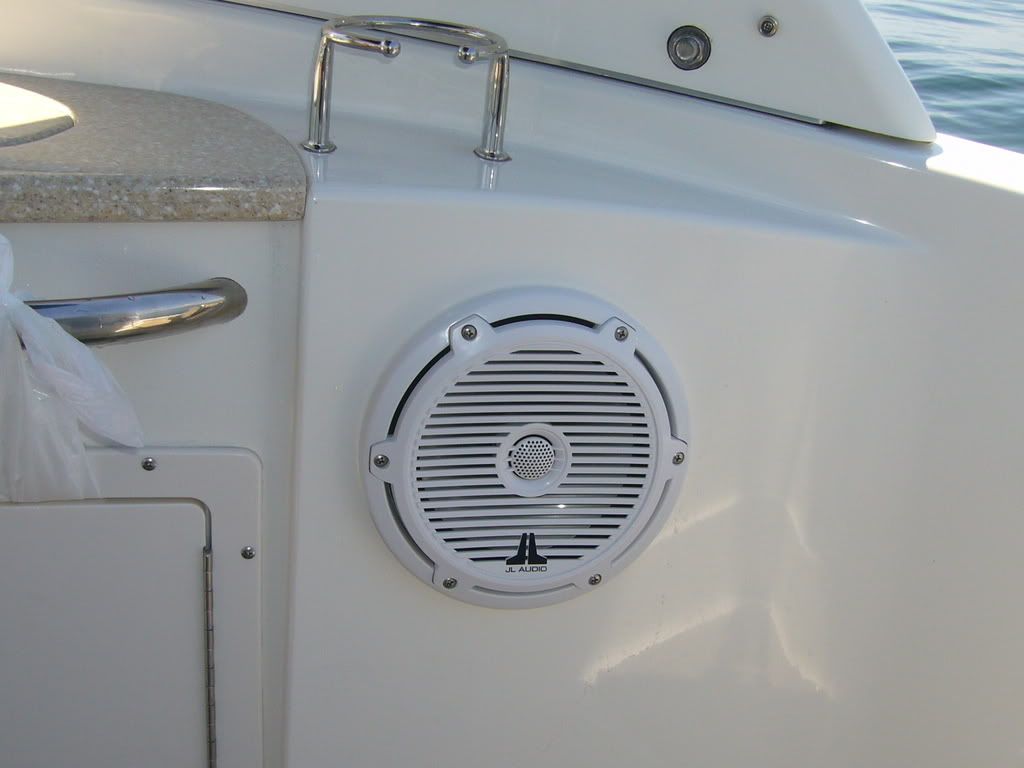

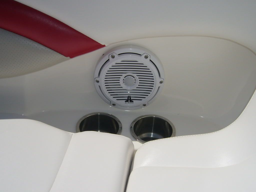

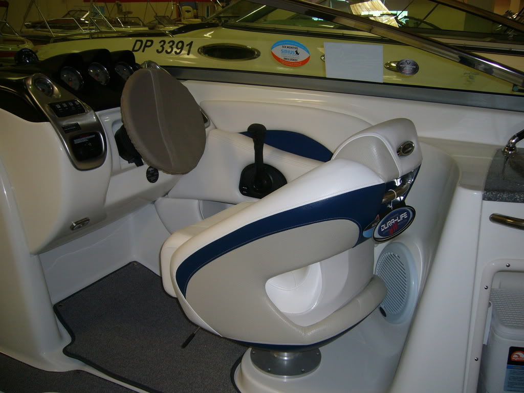

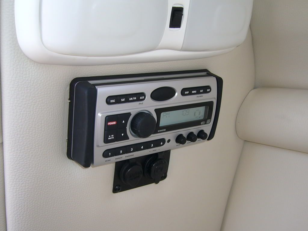

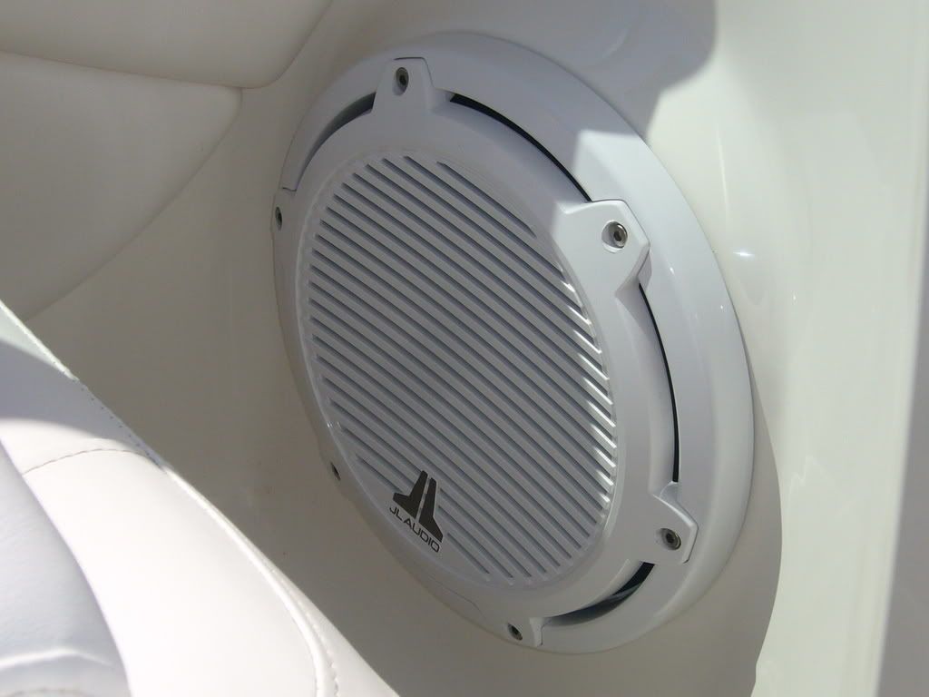

#7 9rumrum
9rumrum
  • Members
  • 119 posts
  • Location:BC Canada/ Abu Dhabi UAE
Posted 09 August 2008 - 12:27 AM

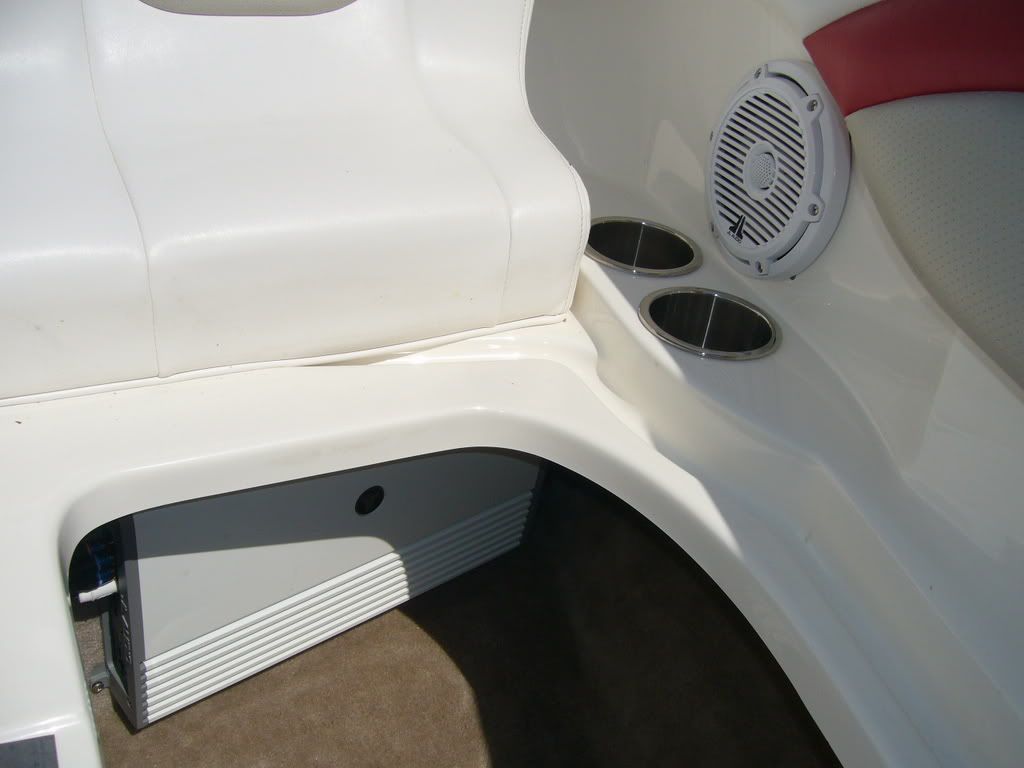

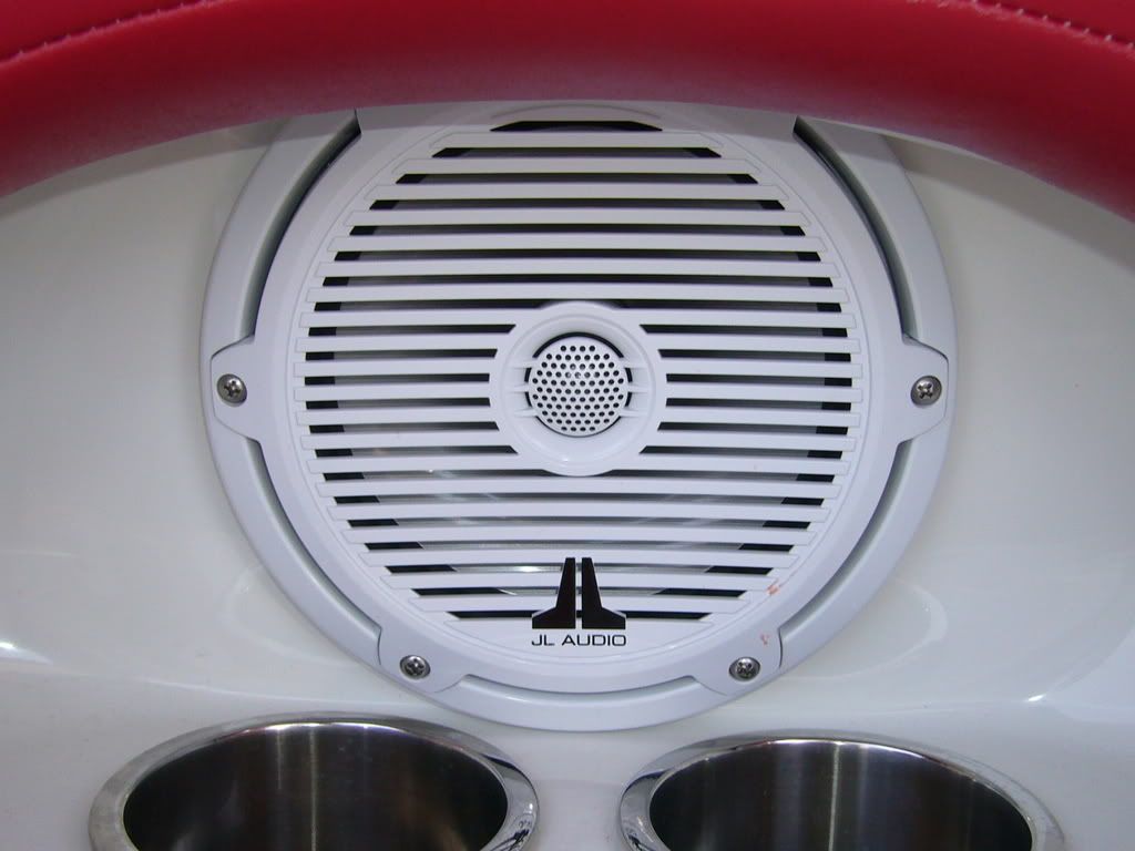

Here are the pics.
Posted Image
Posted Image
Posted Image
Posted Image
Posted Image
Posted Image
Posted Image
Posted Image

#8 CBD
CBD
  • Members
  • 6 posts
Posted 09 August 2008 - 07:39 AM
9rumrum,
What is the third last pic showing, some sort of aux. input and were is it located?
thanks again

#10 9rumrum
9rumrum
  • Members
  • 119 posts
Posted 09 August 2008 - 12:29 PM
The only Aux input in the boat was in the lav. So I split the aux output on the head unit and added another one to just to the left of the passenger seat, underneath the armrest so anyone can use their ipod.
